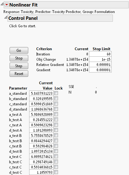

The Nonlinear Fit window appears (Figure 12.17). In the Control Panel, parameter values and locking options are shown. The letters listed before each parameter correspond to variables from the Prediction Model in the Fit Curve function.
Figure 12.17 Nonlinear Fit Control Panel

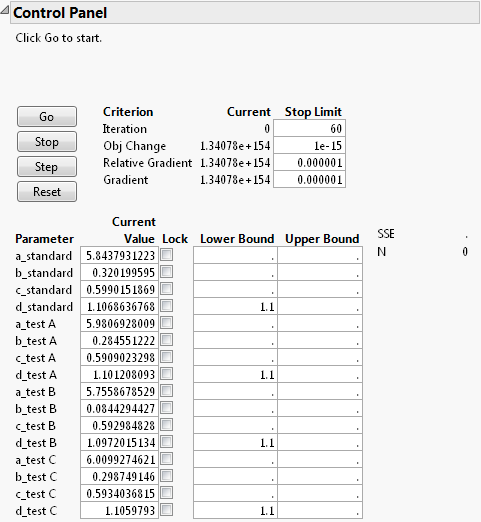

Set the lower bounds for the parameters as shown in Figure 12.18. You know from prior experience that the maximum toxicity of the drug is at least 1.1.
Figure 12.18 Setting Parameter Bounds

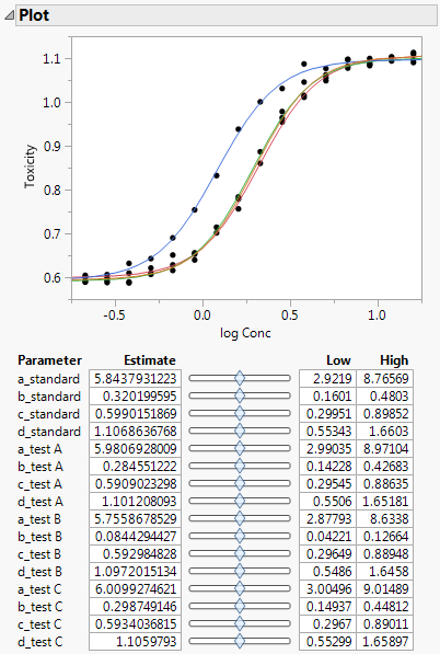

Click Go.
The final parameter estimates are shown in the Solution report, along with other fit statistics (Figure 12.19). The fitted model is shown on the plot.
Figure 12.19 Nonlinear Fit Plot and Parameter Estimates
