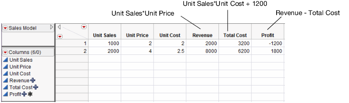

dt = New Table( "Sales Model" );
dt << New Column( "Unit Sales", Values( {1000, 2000} ) );
dt << New Column( "Unit Price", Values( {2, 4} ) );
dt << New Column( "Unit Cost", Values( {2, 2.5} ) );
dt << New Column( "Revenue",
	Formula( :Unit Sales * :Unit Price )
dt << New Column( "Total Cost",
	Formula( :Unit Sales * :Unit Cost + 1200 )
dt << New Column( "Profit",
	Formula( :Revenue - :Total Cost ),
	Set Property( "Spec Limits", {LSL( 0 )} )
Profiler(
	Y( :Revenue, :Total Cost, :Profit ),
	Objective Formula( Profit )
The script creates the data table in Figure 7.24 with some initial scaling data and stores formulas into the output variables. It also launches the Prediction Profiler.
Figure 7.24 Data Table Created from Script

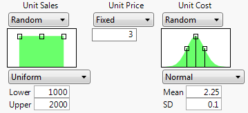

In the menus beneath Unit Sales and Unit Cost, select Random.
Unit Sales is Uniform with Lower limit 1000 and Upper limit 2000.
Unit Price is Fixed at 3.
Unit Cost is Normal with mean of 2.25 and standard deviation of 0.1.
Figure 7.25 Specifications for Prediction Profiler
