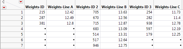

This example uses the file Fill Weights.xlsx, which contains the weights of cereal boxes randomly sampled from three different production lines. Figure 6.38 shows the format of the data.
Figure 6.38 Data Format
Use the File > Open option to import data from a Microsoft Excel file using the Excel Import Wizard. See Import the Data Using the Excel Import Wizard. This method is convenient for any Excel file.
Copy and paste data from Microsoft Excel into a new JMP data table. See Copy and Paste the Data from Excel. You can use this method with small data files.
For more information on how to import data from Microsoft Excel, see Import Microsoft Excel Files in the Using JMP book.
Select Help > Sample Data Library and open Fill Weights.xlsx located in the Samples/Import Data folder.
Type 3 next to Column headers start on on row.
Type 2 for Number of rows with column headers.
Click Import.
Figure 6.39 JMP Table Created Using Excel Import Wizard

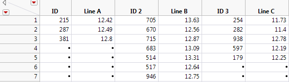

Open Fill Weights.xlsx in Microsoft Excel.
Right-click and select Copy.
In JMP, select File > New > Data Table.
5.
Select Edit > Paste with Column Names.
The Edit > Paste with Column Names option is used when you have column names included in the selection on the clipboard.
Figure 6.40 JMP Table Created Using Paste with Column Names

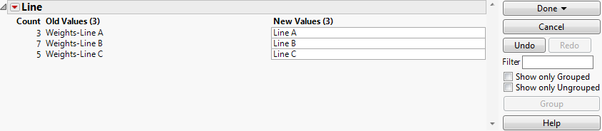

Figure 6.41 Recode Column Values
Click Done > In place.

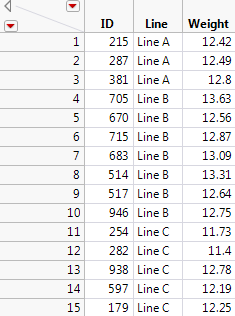

Your new data table is now properly structured for JMP analysis. Each row contains data for a single cereal box. The first column gives the box ID, the second gives the production line, and the third gives the weight of the box (Figure 6.42).
Figure 6.42 Recoded Data Table

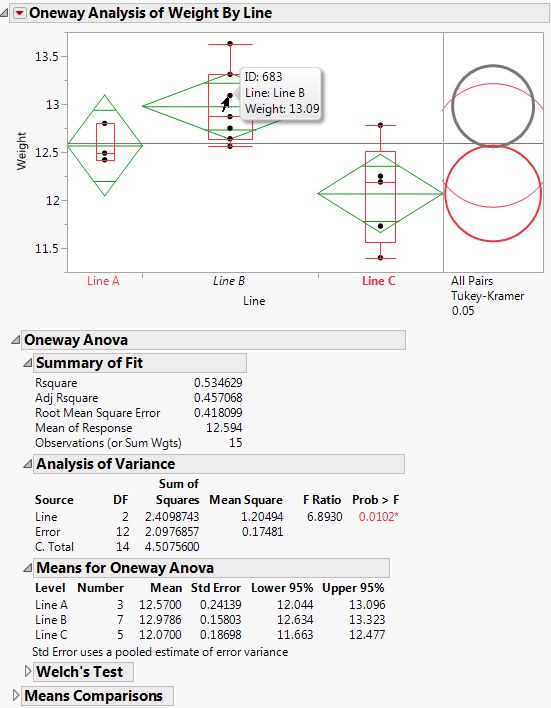

In the plot, hover over the points with your mouse to see their ID values, as well as their Line and Weight data. See Figure 6.43.
9.
From the red triangle menu, select Compare Means > All Pairs, Tukey HSD.
Figure 6.43 Oneway Analysis of Weight by Line
