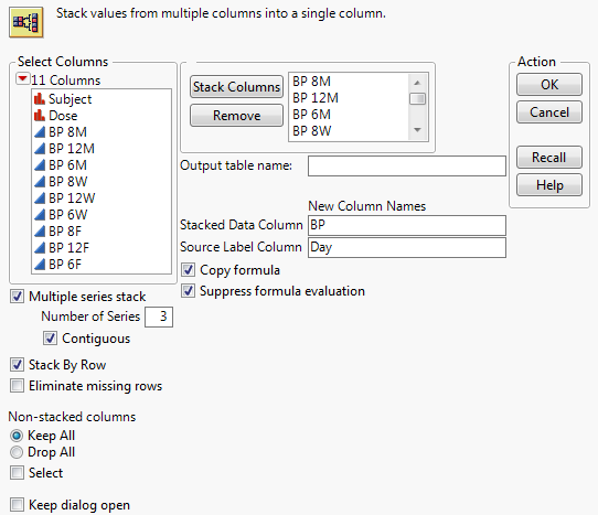

Select Tables > Stack.
Select Multiple series stack.
7.
Rename the Stacked Data Column from Data to BP (for blood pressure).
Figure 5.10 Completed Stack Window
9.

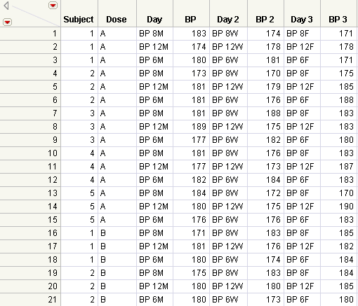

Figure 5.11 Stacked Data Table
The first Day column represents Monday.
The Day 2 column represents Wednesday.
The Day 3 column represents Friday.
