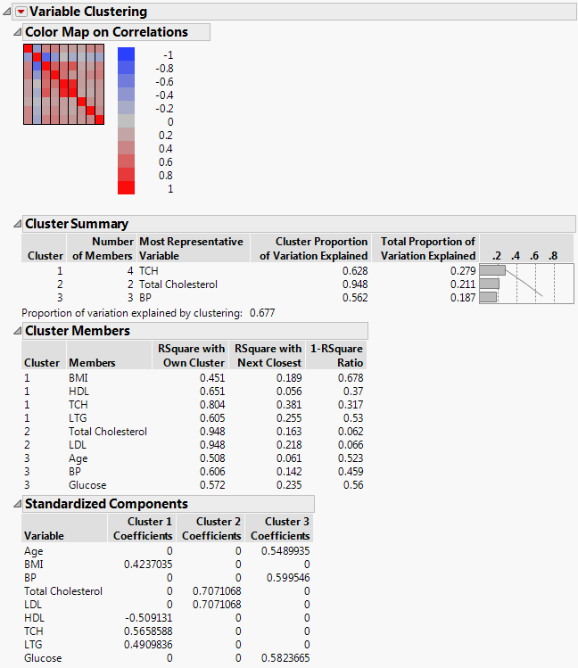

Figure 14.2 Cluster Variables Report for Diabetes Data
The Variable Clustering report is shown in Figure 14.2. The Cluster Summary report shows that the variables were grouped into three clusters:
Cluster 1 consists of BMI, HDL, TCH, and LTG, as shown in the Cluster Members report. The Cluster Summary report shows that TCH is the most representative variable for Cluster 1 and that it explains 62.8% of the Cluster 1 variation.
Cluster 2 consists of Total Cholesterol and LDL. The Cluster summary report shows that Total Cholesterol is the most representative variable for Cluster 2 and that it explains 94.8% of the Cluster 2 variation.
Cluster 3 consists of Age, BP, and Glucose. The Cluster Summary report shows that the most representative variable is BP and it explains 56.2% of the Cluster 3 variation.
