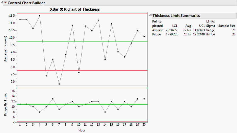

This example uses the Socket Thickness.jmp sample data table, which includes measurements for the thickness of sockets. There has been an increase in the number of defects during production and you want to investigate why this is occurring. Use Control Chart Builder to investigate the variability in the data and the control of the process.
Select Analyze > Quality and Process > Control Chart Builder.
Figure 2.2 Control Charts for Socket Thickness

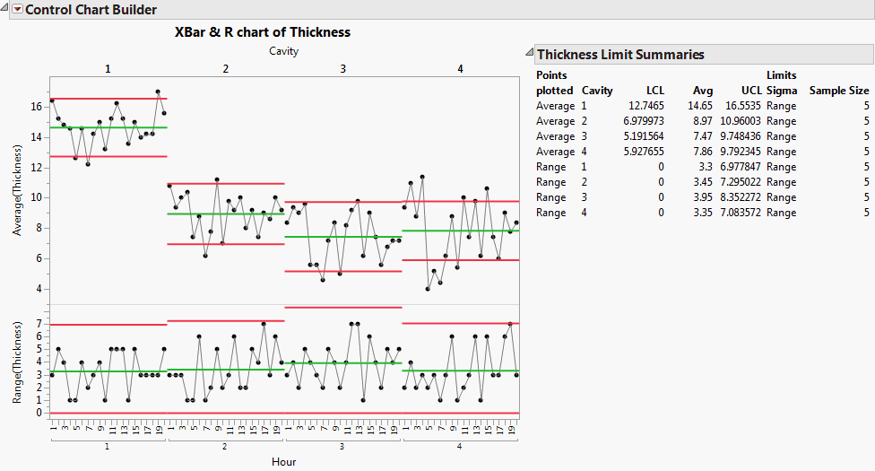

5.
Figure 2.3 Control Charts for Each Cavity
