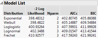

Select Fit All from the Cumulative Damage red triangle menu.
Figure 4.3 Model List Report
Figure 4.3 shows the Model List report. From this report, you determine that the best fitting distribution is the Exponential distribution.

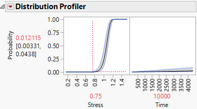

In the Distribution Profiler report, set the current value of Stress to 0.75.
17.
Set the current value of Time to 10000.
Figure 4.4 shows that the predicted probability of failure for a test unit under constant stress of 0.75 at 10000 time units is 0.007233, with a 95% confidence interval of 0.00137 to 0.03776.
