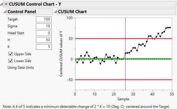

This example uses the Data Units option and reproduces the analysis in Example of CUSUM Control Chart. You want to detect small shifts in the temperature of an engine. The data table contains temperature measurements from the engine thermostat.
Select Analyze > Quality and Process > CUSUM Control Chart.
5.
Click OK.
Figure 4.5 CUSUM Control Chart Report
