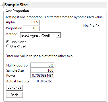

Select DOE > Design Diagnostics > Sample Size and Power.
Click One Sample Proportion.
Leave Alpha as 0.05.
Leave 0.1 as the value for Proportion.
5.
Leave the Method as Exact Agresti-Coull.
6.
Leave the test type as Two-Sided.
7.
Leave 0.2 as the value for Null Proportion.
8.
Enter 100 as the Sample Size.
9.
Click Continue.
Figure 16.12 One Sample Proportion Calculator
