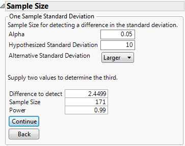

The variance for resistivity measurements on a lot of silicon wafers is claimed to be 100 ohm-cm squared. The buyer is unwilling to accept a lot if the variance is greater than 155 ohm-cm squared. How many wafers must you test to estimate the lot variance with precision to detect an increase in 55 ohm-cm squared from the target of 100 ohm-cm squared? In terms of standard deviation, the hypothesized standard deviation, σ0, is 10 (the square root of 100) and σ is 12.4499 (the square root of 100 + 55 = 155). The difference to detect is 12.4499 – 10 = 2.4499. The desired power is 0.99 and the significance level is 0.05.
Select DOE > Design Diagnostics > Sample Size and Power.
Click One Sample Standard Deviation.
Leave Alpha as 0.05.
Enter 10 for Hypothesized Standard Deviation.
5.
Select Larger for Alternative Standard Deviation.
6.
Enter 2.4499 for Difference to Detect.
7.
Leave Sample Size blank.
8.
Enter 0.99 for Power.
9.
Click Continue.
Figure 16.11 One-Sample Standard Deviation Calculator
