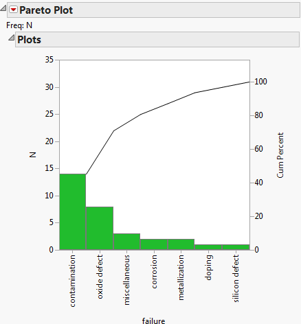

Figure 11.2 Pareto Plot Report Window

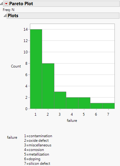

Figure 11.3 Pareto Plot with Display Options
Figure 11.3 shows the counts of different types of failures and has a category legend. The vertical count axis is rescaled and has grid lines at the major tick marks.

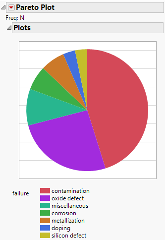

Figure 11.4 Pareto Plot as a Pie Chart
