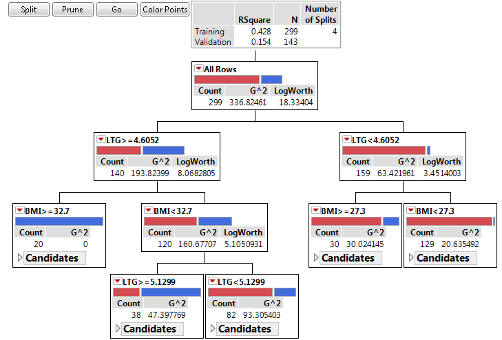

On the platform report window, click Go to perform automatic splitting.
Note: Because you are using a random Validation Portion, your results differ from those in Figure 4.2.
Figure 4.2 Partition Report for Diabetes

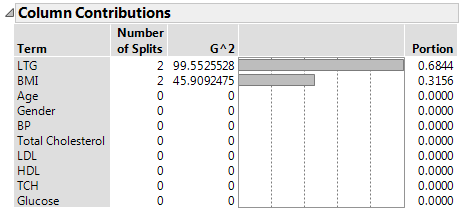

8.
Click the red triangle next to Partition for Y Binary and select Column Contributions.
Figure 4.3 Column Contributions Report
The Column Contributions report shows that LTG and BMI are the only predictors in the decision tree model. Each column is used in two splits. Your results can differ. When the Validation Portion is used, the validation set is selected at random from the data table. If you redo your analysis, a new random validation set is selected and your results can differ from your first run.

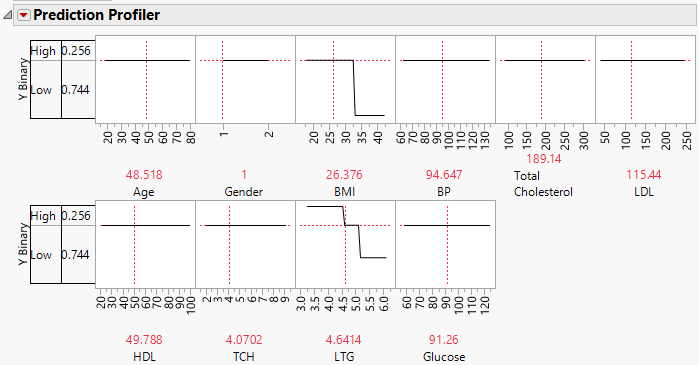

9.
Click the red triangle next to Partition for Y Binary and select Save Columns > Profiler.
Figure 4.4 Profiler for Partition Model
The profiler enables you to change the values of BMI and LTG to obtain the predicted Y Binary outcome. No other factors had a split in the partition model. Their profiles are flat lines.
