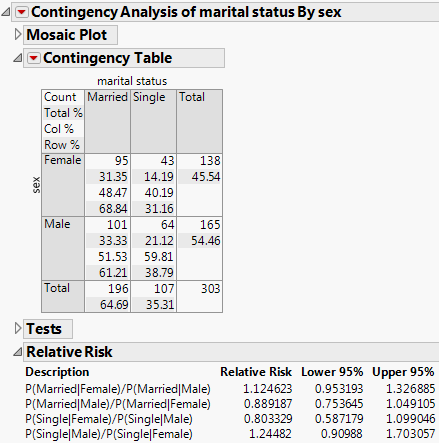

This example uses the Car Poll.jmp sample data table. Examine the relative probabilities of being married and single for the participants in the poll.
Select Analyze > Fit Y by X.

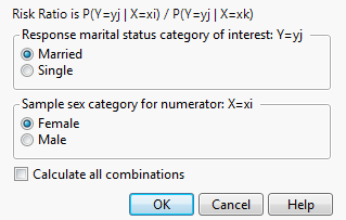

Figure 6.64 The Choose Relative Risk Categories Window
If you are interested in only a single response and factor combination, you can select that here. For example, if you clicked OK in the window in Figure 6.64, the calculation would be as follows:
If you would like to calculate the risk ratios for all (
=4) combinations of response and factor levels, select the Calculate All Combinations check box. See Figure 6.65. |
7.
Ask for all combinations by selecting the Calculate All Combinations check box. Leave all other default selections as is.
Figure 6.65 Example of the Risk Ratio Report
= 1.1247
