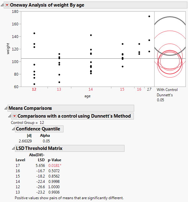

1.
Select Help > Sample Data Library and open Big Class.jmp.
2.
Select Analyze > Fit Y by X.
3.
Select weight and click Y, Response.
4.
Select age and click X, Factor.
5.
6.
From the red triangle menu, select Compare Means > With Control, Dunnett’s.
Alternatively, click on a row to highlight it in the scatterplot before selecting the Compare Means > With Control, Dunnett’s option. The test uses the selected row as the control group.
8.
Figure 6.21 Example of With Control, Dunnett’s Comparison Circles
Using the comparison circles in Figure 6.21, you can conclude that level 17 is the only level that is significantly different from the control level of 12.
