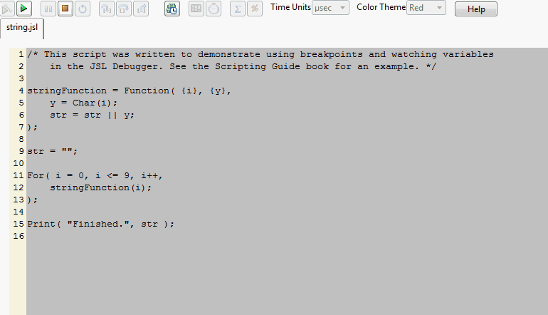

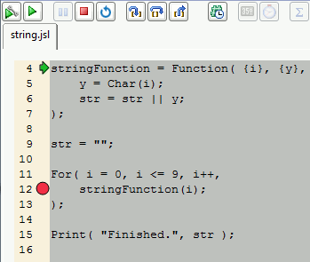

Tip: Make sure that Show Line Numbers is selected on the Debugger Options tab before proceeding.
Open the string.jsl sample script and click the Debug Script button.
stringFunction(i);
Figure 3.11 Set the Breakpoint
Click Run.
stringFunction is defined as a function.
str is defined as an empty string.
Both variables and their types and values have been added to the Globals list. In addition, the For() loop has been evaluated up to the line with the breakpoint, shown in Figure 3.11.
i has been assigned to 0.
i and its value and type have been added to the Globals list.
i has been determined to be less than or equal to 9.
stringFunction() has not yet been called.

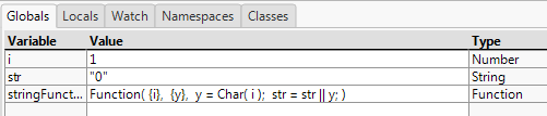

Click Run again.
stringFunction() is called, evaluated, and returns to the loop.
i is incremented and determined to be less than or equal to 9.
In the Globals list, i is now 1 and str is now “0”.
Figure 3.13 Global Variables at First Breakpoint

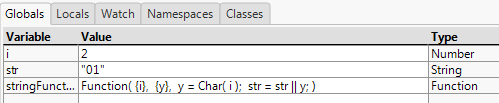

Click Run again.
In the Globals list, i is now 2, and str is now “01”.
Figure 3.14 Global Variables at Second Breakpoint

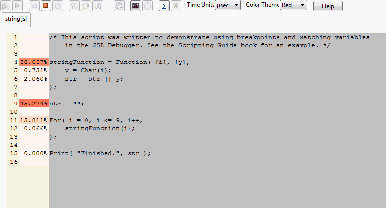

Click the Profile JSL Script button .
Figure 3.15 Initial JSL Profiler Window
Click the Run button to start profiling.
Figure 3.16 Profiled Script Window
In the left margin, the selected statistics are displayed. Percent of time is displayed by default. Click the Show Profile by Count button to switch to percent of statement counts instead. The left margin is color-coded to allow for quick identification of problematic performance areas.
