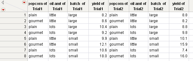

If the two tables have column names that are the same, the names of these columns in the new table appear as “column name of table name.” For example, suppose that you want to combine the eight rows from the Trial1.jmp and Trial2.jmp data tables shown in Figure 5.24 into a single table. You want to combine them so that the new table contains all of the columns from both tables.
Select Help > Sample Data Library and open Trial1.jmp andTrial2.jmp.
From the Trial1.jmp data table, select Tables > Join.
In the Join...with box, select Trial2.
5.
Figure 5.24 Original Tables and the Joined Table

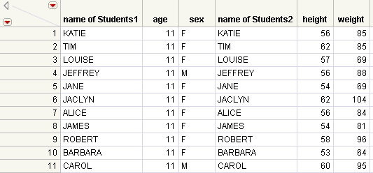

Select Help > Sample Data Library and open Students1.jmp and Students2.jmp.
The Students1.jmp data table contains names, ages, and sexes of the students. The Students2.jmp data table contains names, height, and weight of the students. Instead of working with two separate tables, you would like to combine the tables into one. Notice that the students’ names are not in the same order in both tables. For example, Alice is in row 7 and row 9.
From the Students1.jmp data table, select Tables > Join.
In the Join...with box, select Students2.
Because both tables have one column (name) that contains the same values, you need to tell JMP that they are matches. JMP then examines each of the values in the name column of the first table to determine whether there was a corresponding value in the second table’s name column. For example, it detects that Alice is located in both tables. It creates a name column in the new table with Alice as a value. It then takes the age and sex of Alice from table one and puts it in the new table. Then it takes the height and weight of Alice and puts them in the new table.
Select By Matching Columns in the Matching Specification area.
5.
From the Students1 and Students2 lists, select name.
6.
Click Match.
8.
Figure 5.29 Joined Table

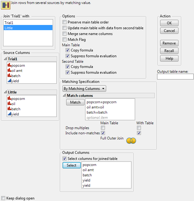

Select Help > Sample Data Library and open Trial1.jmp and Little.jmp.
From the Trial1.jmp table, select Tables > Join.
In the Join...with box, select Little.
You can see that three of the columns (popcorn, oil amt/oil, and batch) contain the same values in both tables. Identify these columns as matches. Also, because Sarah and Joe gave the oil and oil amt columns different names, you can tell JMP that oil amt and oil match.
Deselect Preserve main table order.
5.
6.
From the Trial1 list, select popcorn, oil amt, and batch.
7.
From the Little list, select popcorn, oil, and batch.
8.
Click Match.
Looking at the two data tables, you can see that they have different numbers of rows. Trial1.jmp has values for eight experimental conditions, and Little.jmp has values for only four of those conditions. Sarah completed her experiment, but Joe only partially completed his experiment. You want the joined table to contain all of the rows in Trial1.jmp. even if that row in the Little.jmp table contains a missing value.
9.
Select the Include non-matches boxes for both tables.
In the joined table, you want only one column for popcorn, one column for oil, and one column for batch. However, you want two columns for yield: one representing the yield from Trial1.jmp, and another representing the yield from Little.jmp.
10.
Select the box beside Select columns for joined table.
11.
From the Trial1 list, select all of the columns.
12.
Click Select.
13.
From the Little list, select yield.
14.
Click Select.
Figure 5.30 Completed Join Window

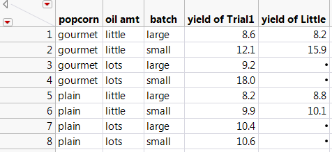

15.
Figure 5.31 Trial1.jmp and Little.jmp Joined
The joined table is sorted by the matching columns. Note that the yield column from the Little.jmp table (Yield of Little) has missing values indicating no matching values with the Trial1.jmp table.

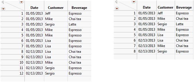

Select Help > Sample Data Library and open Coffee Shop Purchases.jmp.
Select Tables > Join.
In the Join...with box, select Coffee Shop Purchases.
6.
Click Match.
7.
Select the Drop multiples boxes for both tables (the Main Table and the With Table).
8.
Type Coffee Shop Purchases Final for the Output table name.
9.
Figure 5.32 Original and Joined Coffee Shop Purchases Data Tables
