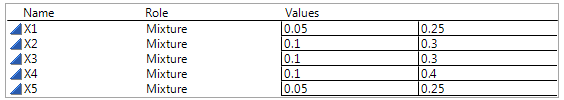

Select DOE > Classical > Mixture Design.
Figure 12.12 Ranges for Five-factors

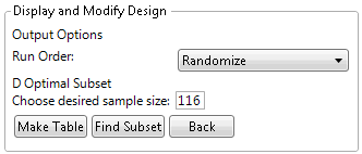

Enter 4 in the Degree text box and click Extreme Vertices.
Figure 12.13 Display and Modify Panel for Extreme Vertices Example
6.
Note: The Find Subset option uses the row exchange method (not coordinate exchange) to find the optimal subset of rows.

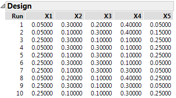

Figure 12.14 Ten Run D-optimal Extreme Vertices Design
7.
Click Make Table.

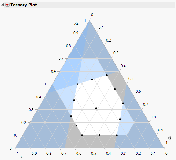

From the design table, select Graph >Ternary Plot.
9.
Select X1, X2, X3, X4, and X5 and click X, Plotting, and then click OK.
Figure 12.15 Partial Output of Ternary Plot for Five-Factor Design

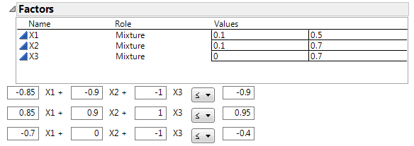

Consider the classic example presented by Snee (1979) and Piepel (1988). This example has three factors, X1, X2, and X3, with factor bounds and three linear constraints.
Enter the values from Figure 12.16 for X1, X2, and X3 and click Continue.
Figure 12.16 Values and Linear Constraints for the Snee and Piepel Example
Click Linear Constraint three times. Enter the constraints as shown in Figure 12.16.

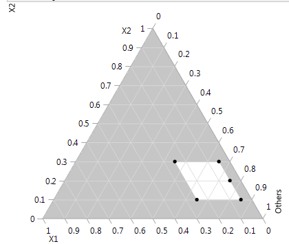

7.
Select X1, X2, and X3 and click X, Plotting, and then click OK.
Figure 12.17 Ternary Plot Showing Piepel Example with Constraints
