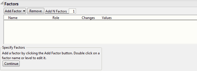

Figure 3.18 Factors Outline
Adds multiple factors. Enter the number of factors to add, click Add Factor, and then select the factor type. Repeat Add N Factors to add multiple factors of different types.
The name of the factor. When added, a factor is given a default name of X1, X2, and so on. To change this name, double-click it and enter the desired name.
To remove a factor level, click the value, click Delete, and click outside the text box.
To modify the entry under Changes, click the value in the Changes column and select the appropriate entry.
To choose a factor type, click Add Factor in Custom Design.
The default values for a discrete numeric factor with k levels, where k > 2, are the integers 1, 2, ..., k. The default values for a discrete numeric factor with k = 2 levels are -1 and 1. Replace the default values with the settings that you plan to use in your experiment.
