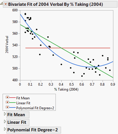

Using the Fit Line option, you can add straight line fits to your scatterplot using least squares regression. Using the Fit Polynomial option, you can fit polynomial curves of a certain degree using least squares regression.
Figure 4.31 Example of Fit Line and Fit Polynomial
Figure 4.31 shows an example that compares a linear fit to the mean line and to a degree 2 polynomial fit.
The Fit Line output is equivalent to a polynomial fit of degree 1.
The Fit Mean output is equivalent to a polynomial fit of degree 0.
