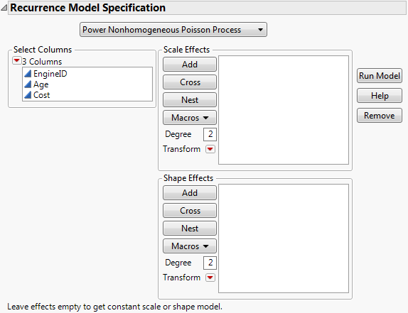

Figure 5.6 Recurrence Model Specification
Table 5.1 defines each model parameter as a scale parameter or a shape parameter.
For the Recurrence Model Specification window (Figure 5.6), if you include Scale Effects or Shape Effects, the scale and shape parameters in Table 5.1 are modeled as functions of the effects. To fit the models with constant scale and shape parameters, do not include any Scale Effects or Shape Effects.

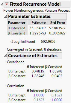

Click Run Model to fit the model and see the model report (Figure 5.7).
Figure 5.7 Model Report
