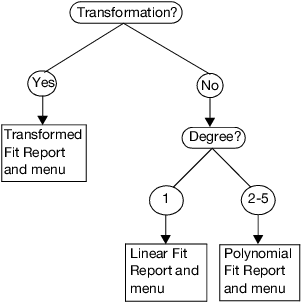

Figure 4.37 Example of Fit Special Flowchart
The Transformed Fit report contains the reports described in Linear Fit and Polynomial Fit Reports. However, if you transformed Y, the Fit Measured on Original Scale report appears. This shows the measures of fit based on the original Y variables, and the fitted model transformed back to the original scale.
