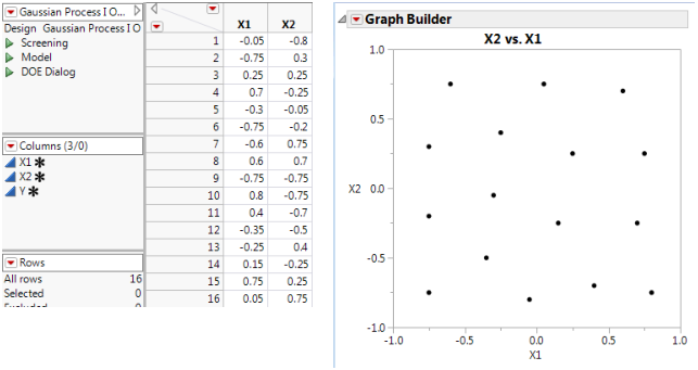

Gaussian process IMSE optimal designs are alternatives to the Latin Hypercube design. You can compare the IMSE optimal design to the Latin Hypercube (shown previously in Figure 20.20). The table and overlay plot in Figure 20.22 show a Gaussian IMSE optimal design. You can see that the design provides uniform coverage of the factor region.
