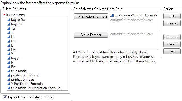

Select Expand Intermediate Formulas.
Figure 20.26 Profiler Dialog for Borehole Sphere-Packing Data
10.
Click OK.

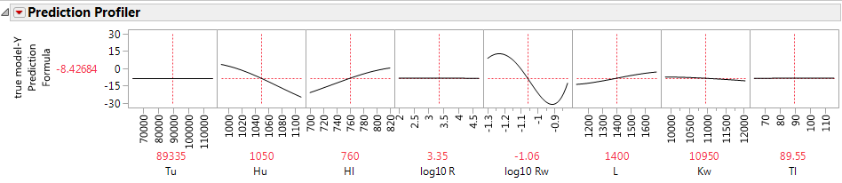

The profiler defaults to the center of the design region. If there were no bias, all profile traces would be constant between the value ranges of each factor. In this example, the variables logRw, Hu, and Hl show the largest effects on the bias.

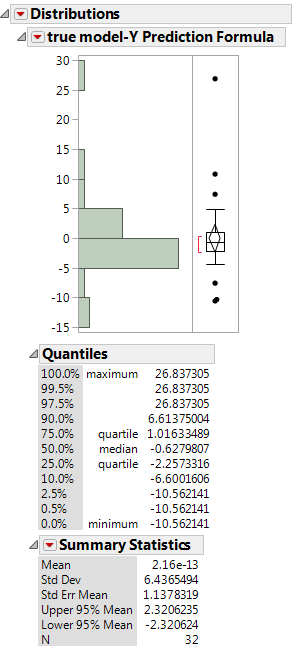

You can use the profiler to explore the range of the prediction bias over the entire domain. To find points of minimum and maximum bias, select Optimization and Desirability > Desirability Functions from the Prediction Profiler red triangle menu. See Desirability Profiling and Optimization in the Profilers book. To evaluate the prediction bias over the design points, select Analyze > Distribution to see a distribution analysis.
Figure 20.28 Distribution of the Prediction Bias
