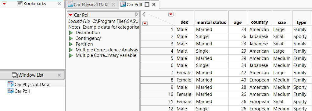

Create a group for the data tables by selecting New Group from the Bookmarks red triangle menu. The group organizes the files but does not move them on your computer.
Figure 9.12 Bookmarked Files

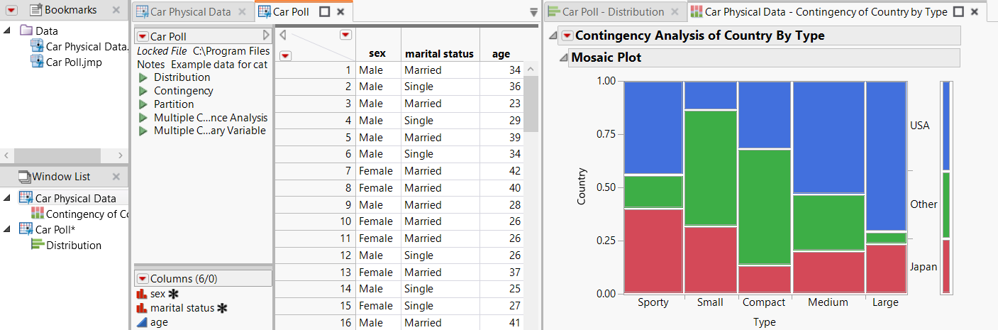

In Car Physical Data.jmp, run the Contingency script.
In Car Poll.jmp, run the Distribution script.
Figure 9.13 Tabbed Reports

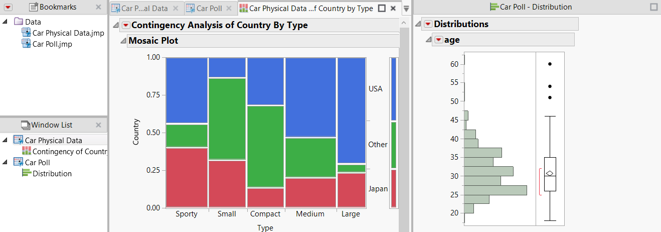

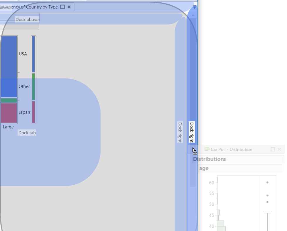

Drag the Distribution report tab to the right until the Dock right zone appears on the far right.
Figure 9.14 Dragging a Report
Drop the report into the Dock right zone.
Figure 9.15 Report in New Pane

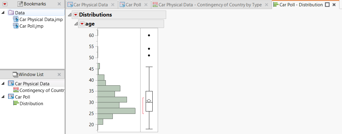

6.
When the Dock tab zone appears, drop the report.
Figure 9.16 Docked Report Tabs
