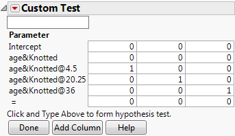

Click the Add Column button twice to produce a total of three columns.
10.
11.
Figure 3.22 Values for the Custom Test for Curvature

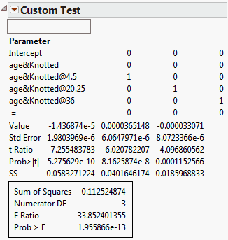

Click Done.
The report in Figure 3.23 appears. The small Prob > F value indicates that there is curvature.
