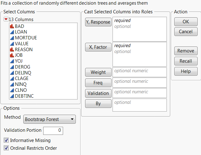

Launch the Bootstrap Forest platform by selecting Analyze > Predictive Modeling > Bootstrap Forest.
Figure 5.7 Bootstrap Forest Launch Window
For more details about these methods, see Partition Models, Boosted Tree, K Nearest Neighbors, and NaiveBayes.
If selected, enables missing value categorization for categorical predictors and informative treatment of missing values for continuous predictors. See Informative Missing in Partition Models.

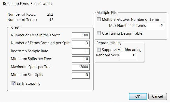

After you select OK in the launch window, the Bootstrap Forest Specification window appears.
Figure 5.8 Bootstrap Forest Specification Window
Opens a window where you can select a data table containing values for the Forest panel tuning parameters, called a tuning design table. A tuning design table has a column for each option that you want to specify and has one or multiple rows that each represent a single Bootstrap Forest model design. If an option is not specified in the tuning design table, the default value is used.
