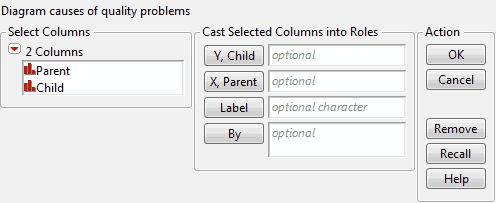

Launch the Diagram platform by selecting Analyze > Quality And Process > Diagram.
Figure 12.4 The Diagram Launch Window
Tip: To create a basic diagram that is not based on a data table, leave the Y, Child, and X, Parent fields empty and click OK. Then edit the nodes using the options in the right-click menu. See Right-Click Menus.
