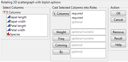

Figure 5.3 The Scatterplot 3D Launch Window
Use the Weight variable to:
Note: Red triangle options account for the Weight variable. If you do not want this variable accounted for in your analyses, remove it from the launch window.
When you specify a Weight variable, JMP draws the points as balls. The balls are scaled so that their volume represents the weight value. You click and drag the Circle Size slider below the scatterplot to resize the balls.
After you click OK, the Scatterplot 3D report window appears. See The Scatterplot 3D Report.
