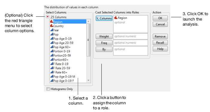

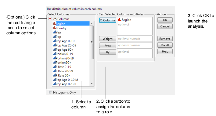

The launch window is your point of entry into a platform, where you specify the columns to analyze. Figure 1.11 shows the Distribution launch window.
Figure 1.11 Launch Window Features
Moves selected columns into roles (such as Y, X, and so on.) You cast a column into the role of a variable (like an actor is cast into a role). See Cast Selected Columns into Roles Buttons.
