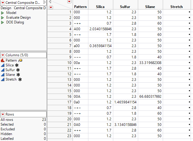

Click Make Table to create a design table that contains the runs for your experiment.
Figure 10.17 Orthogonal Central Composite Design for Bounce Factors and Response
The Design note in the Table panel at the upper left gives the design type that generated the table (Central Composite Design). This information can be helpful if you are comparing multiple designs.
A Pattern column gives a symbolic description of the run in each row in terms of the factor values.
Tip: Pattern can be a useful label variable in plots.
