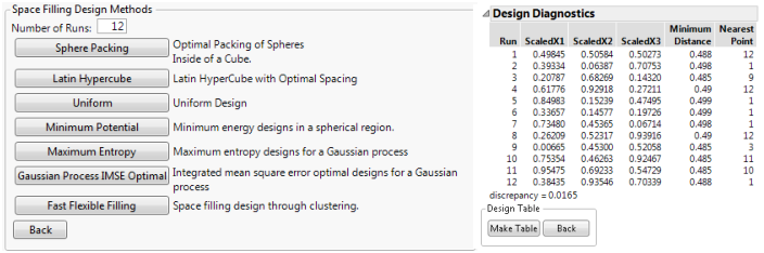

In the design specification dialog (shown on the left in Figure 20.18), enter a sample size (Number of Runs). This example uses a sample size of 12.
6.
Click the Minimum Potential button. JMP creates this design and displays the design runs and the design diagnostics (shown on the right in Figure 20.18).

Click Make Table.
