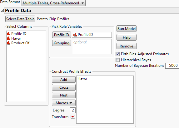

Click Select Data Table under Profile Data.
6.
Select Potato Chip Profiles.jmp and click OK.
7.
Select Profile ID from the Select Columns list and click Profile ID under Pick Role Variables.
8.
Select Flavor and click Add under Construct Model Effects.
Note that Product Of is another profile effect that you could add to the effects list.
Figure 5.5 Complete Profile Data Outline

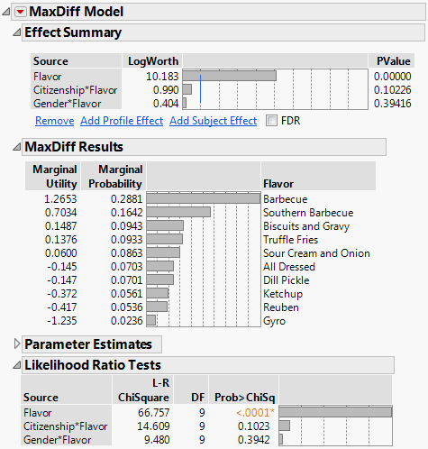

Click Run Model.
Figure 5.8 MaxDiff Model Report
The Effect Summary report in Figure 5.8 shows the terms in the model and gives p-values for their significance. Notice that Flavor is a profile effect, and that each of Citizenship*Flavor and Gender*Flavor is an interaction of a subject and a profile effect.
