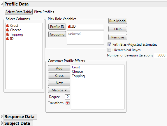

From the Data Format menu, select Multiple Tables, Cross-Referenced.
Click Select Data Table under Profile Data.
5.
Select Pizza Profiles.jmp and click OK.
6.
Select ID and click Profile ID.
7.
Select Crust, Cheese, and Topping and click Add.
Figure 4.5 Profile Data

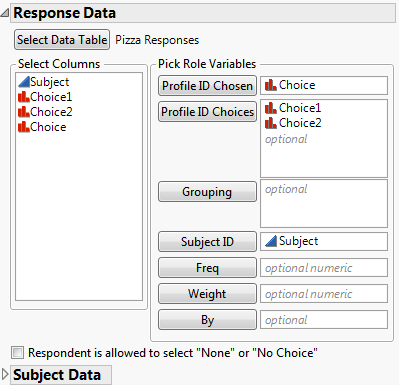

9.
Select Pizza Responses.jmp and click OK.
Select Choice and click Profile ID Chosen.
Select Choice1 and Choice2 and click Profile ID Choices.
Select Subject and select Subject ID.
Figure 4.6 Response Data Window
Choice1 and Choice2 are the profiles presented to a subject in each of four choice sets. The Choice column contains the chosen preference between Choice1 and Choice2.

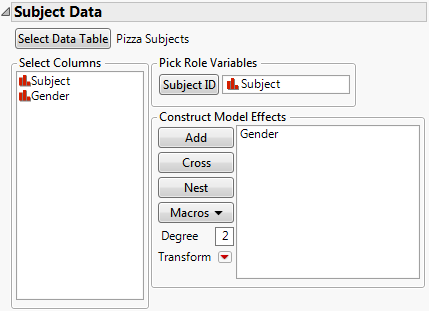

Select Pizza Subjects.jmp and click OK.
13.
Select Subject and click Subject ID.
14.
Select Gender and click Add.
Figure 4.7 Subject Data Window

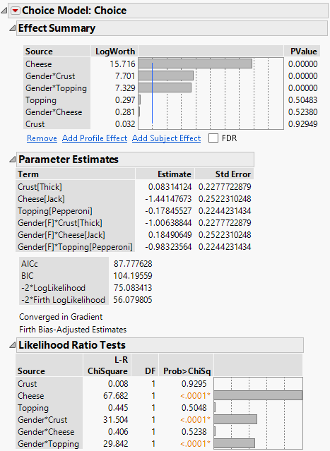

Click Run Model.
Figure 4.8 Choice Model Results
Six effects are entered into the model. The effects Crust, Cheese, and Topping are product attributes. The interaction effects, Gender*Crust, Gender*Cheese, and Gender*Topping are subject-effect interactions with the attributes. These interaction effects enable you to construct products that meet market-segment preferences.
The Effect Summary and Likelihood Ratio Tests reports show strong interactions between Gender and Crust and between Gender and Topping. Notice that the main effects of Crust and Topping are not significant. If you had not included subject-level effects, you might have overlooked important information relative to market segmentation.

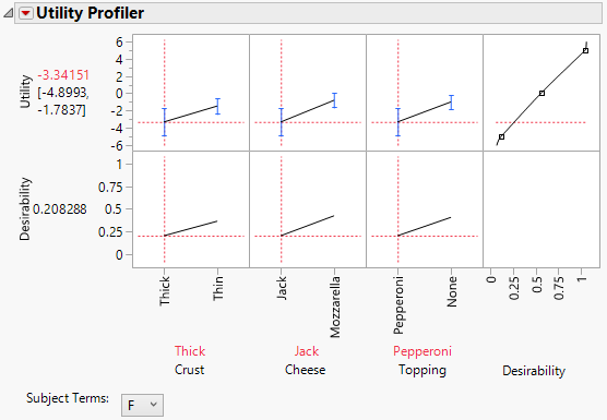

Click the red triangle next to Utility Profiler and select Optimization and Desirability > Desirability Functions.
Figure 4.9 Utility Profiler with Desirability Function

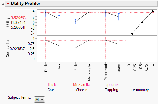

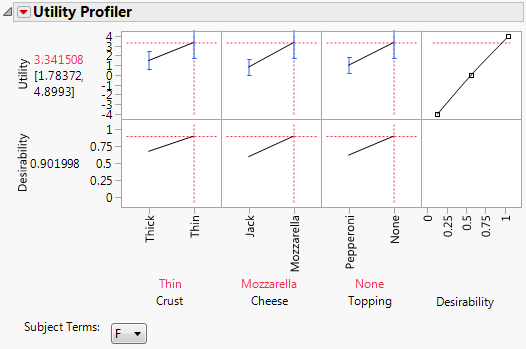

Click the red triangle next to Utility Profiler and select Optimization and Desirability > Maximize Desirability.
Figure 4.10 Utility Profiler with Optimal Settings for Females
Figure 4.11 Utility Profiler with Male Level Factor Setting
