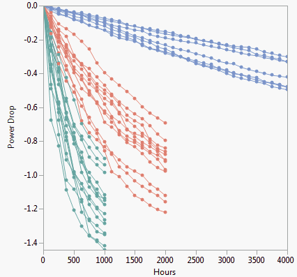

Figure 6.7 shows the initial overlay plot of the data.
Figure 6.7 Device B Overlay Plot

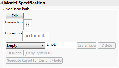

The degradation paths appear linear for the first several hundred hours, but then start to curve. To fit a nonlinear model, select Degradation Path Style > Nonlinear Path from the platform red triangle menu to show the Nonlinear Path Model Specification outline. See Figure 6.8.
Note: To view the Edit button displayed in Figure 6.8, you must select the interactive formula editor preference (File > Preferences > Platforms > Degradation > Use Interactive Formula Editor) prior to launching the Degradation platform.
The first step to create a model is to select one of the options on the menu initially labeled Empty:

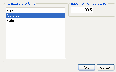

The Reaction Rate options are applicable when the degradation occurs from a single chemical reaction, and the reaction rate is a function of temperature only. Select Reaction Rate or Reaction Rate Type 1 from the menu shown in Figure 6.8. Although similar to the Reaction Rate model, the Reaction Rate Type 1 model contains an offset term that changes the basic assumption concerning the response value’s sign.
Figure 6.9 Unit and Baseline Selection
For this example, select Reaction Rate and then select Celsius as the Temperature Unit. Click OK to return to the report. For details about all the features for Model Specification, refer to Model Specification Details.

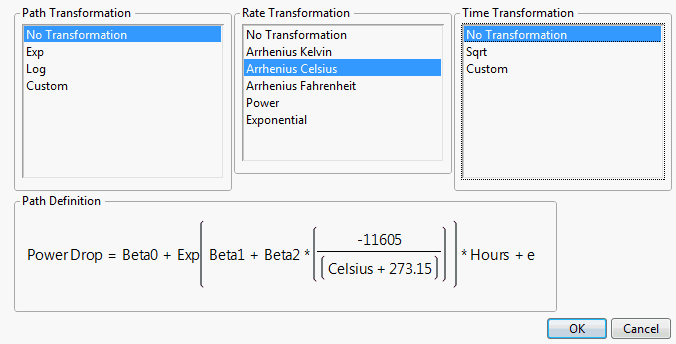

Select Constant Rate from the menu shown in Figure 6.8. The Constant Rate Model Settings window prompts you to enter transformations for the Path, Rate, and Time.
Figure 6.10 Constant Rate Transformation
Once a selection is made for each transformation, the associated formula appears in the lower left corner as shown in Figure 6.10.
After all selections are made, click OK to return to the report. For details about all the features for Model Specification, refer to Model Specification Details.

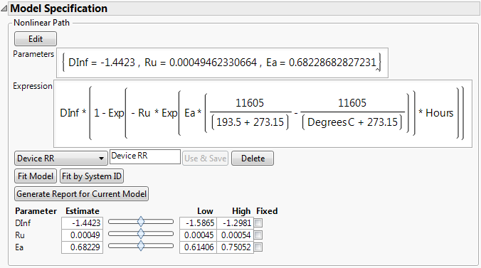

If desired, enter a name in the text box to name the model. For this example, use the name “Device RR”. After that, click the Use & Save button to enter the model and activate the other buttons and features. Figure 6.12 shows the Model Specification window after clicking the Use & Save button.
Figure 6.12 Model Specification
The Fit Model button is used to fit the model to the data.
The Delete button is used to delete a model from the model menu.
The Generate Report for Current Model button creates a report for the current model settings. See Model Reports.
The initial parameter values are shown at the bottom, along with sliders for visualizing how changes in the parameters affect the model. To do so, first select Graph Options > Show Fitted Lines from the platform red-triangle menu to show the fitted lines on the plot. Then move the parameter sliders to see how changes affect the fitted lines.
Ea (Ea) - reaction-specific activation energy
where RU is the reaction rate at use temperature tempU, RU x AF(temp) is the reaction rate at a general temperature temp, and for temp > tempU, AF(temp) > 1
AF(temp) =
To fix a value for a parameter, check the box under Fixed for the parameter. When fixed, that parameter is held constant in the model fitting process.

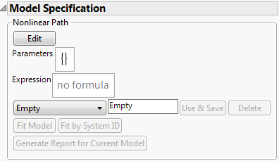

You can use the Formula Editor to enter a model. Click the Edit button to open the Formula Editor to enter parameters and the model. For details about entering parameters and formulas in the Formula Editor, see Formula Editor in the Using JMP book.
Note: To view the Edit button displayed in Figure 6.13, you must select the interactive formula editor preference (File > Preferences > Platforms > Degradation > Use Interactive Formula Editor) prior to launching the Degradation platform.
