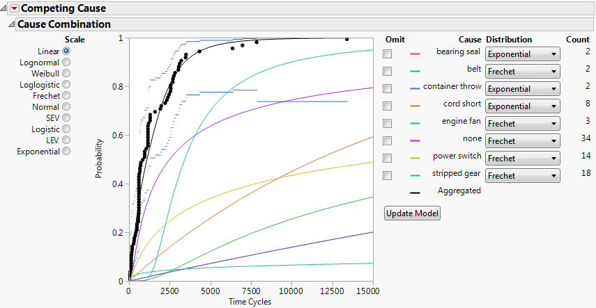

Select Individual Best as the Distribution.
7.
Make sure that AICc is the Comparison Criterion.
8.
Click OK.
Figure 2.11 Initial Competing Cause Report
Figure 2.12 Estimated Failure Time for 10% of the Units
10.
Select Omit for bearing seal, belt, container throw, cord short, and engine fan (the causes with the fewest failures).
Figure 2.13 Updated Failure Time
