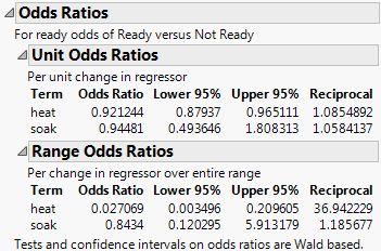

Shows or hides an Odds Ratios report that contains Unit Odds Ratios and Range Odds Ratios, as shown in Figure 10.6.
Figure 10.6 Odds Ratios
