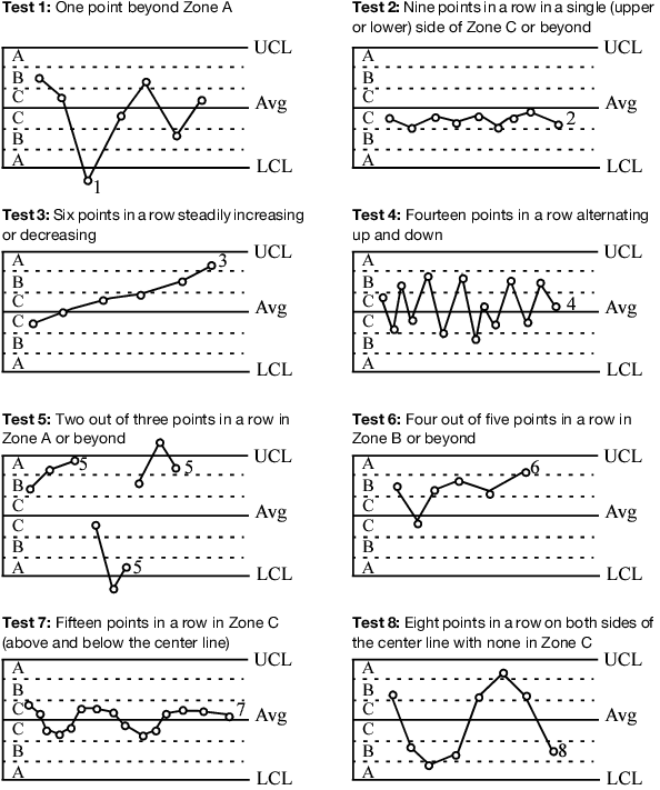

Table 2.8 lists and interprets the eight tests, and Figure 2.7 illustrates the tests. The following rules apply to each test:

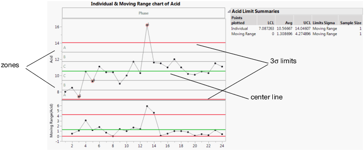

Figure 2.6 Zones for Western Electric Rules
Detects a shift in the mean, an increase in the standard deviation, or a single aberration in the process. For interpreting Test 1, any dispersion chart (R-, S-, or MR-) can be used to rule out increases in variation.
