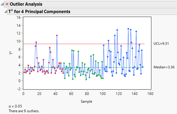

Figure 3.11 Outlier Analysis Report
By default, the Outlier Analysis report displays the T2 for <A> Principal Components plot. The plot shows the T2 value for each observation and horizontal lines at the Median and Upper Control Limit (UCL). For details about how the T2 values, median, and UCL are calculated, see Calculations for Outlier Analysis.
The α level used to calculate the UCL is displayed below the plot. The number of outliers detected is also shown. This number is the number of observations with T2 values that are greater than the UCL.
T2 Plot
