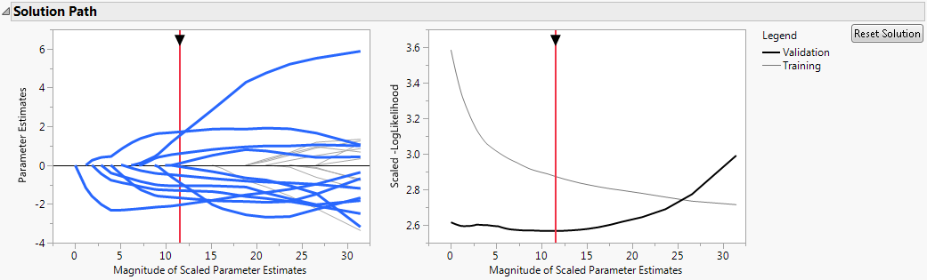

Click the red triangle next to Adaptive Lasso with Validation Column and select Select Nonzero Terms.
The Solution Path is shown in Figure 6.1. The paths for terms that have nonzero coefficients are highlighted. Think of the solution paths as moving from right to left across the plot, as the solutions shrink farther from the MLE. A number of terms have paths that shrink them to zero fairly early.

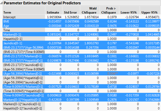

The Parameter Estimates for Original Predictors report (Figure 6.2) shows the parameter estimates for the uncentered and unscaled data. The 11 terms with nonzero parameter estimates are highlighted. These include interaction effects. In the data table, all six predictor columns are selected because every predictor column appears in a term that has a nonzero coefficient.
In the Effect Tests report, the 10 effects with zero coefficient estimates are designated as Removed. The Effect Tests report indicates that only one effect is significant at the 0.05 level: the Age*Markers interaction.
11.
Click on the row for (Age - 56.3994)*Markers[0-1] in the Parameter Estimates for Original Predictors report.
This action highlights that effect’s path in the Solution Path Plot and selects the columns Age and Markers in the data table.
