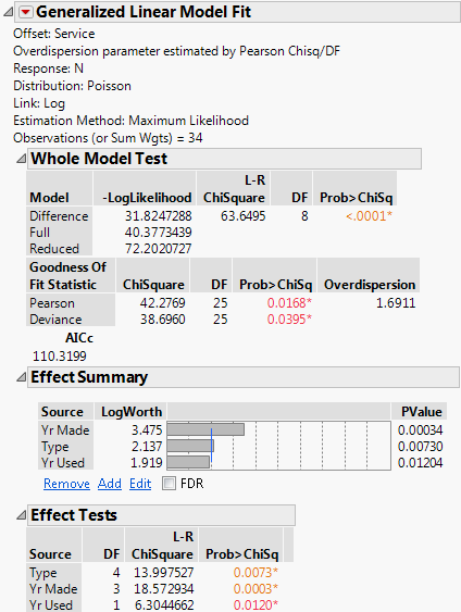

Click Run.
From the report shown in Figure 11.7, notice that all three effects (Type, Yr Made, Yr Used) are significant.
Figure 11.7 Partial Report for a Poisson with Offset Model
