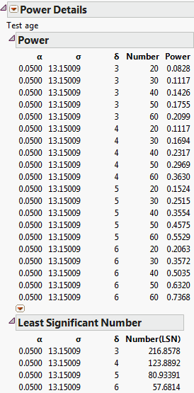

Figure 2.71 Power Details Report for Age
This analysis is a retrospective power analysis because the calculations assume a study with a structure identical to that of the Big Class.jmp sample data table. For example, the calculation of power in this example depends on the effects entered into the model and the number of participants in each age and sex grouping. Also, the value of σ was derived from the current study, though you could have replaced it with a value that would be representative of a future study.
For details about the power results shown in Figure 2.71, see Power. For details about the least significant number (LSN), see The Least Significant Number (LSN).

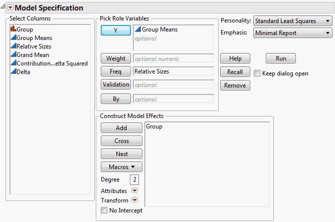

Next, use Fit Model to fit a one-way analysis of variance model (Figure 2.73). Note that Relative Sizes is declared as Freq in the launch window. Also, the Minimal Report emphasis option is selected.
Figure 2.73 Fit Model Launch Window for Bacteria Study

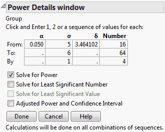

To explore the range of error variation suspected by the scientist, under σ, enter 5 in the first box and 6 in the second box (Figure 2.74).
Note that δ is entered as 3.464102. This is the effect size that corresponds to the specified difference in the group means. The data table contains three hidden columns that illustrate the calculation of the effect size. (See Unbalanced One-Way Layout.)
5.
To explore power over a range of study sizes, under Number, enter 16 in the first box, 64 in the second box, and an increment of 4 in the third box (Figure 2.74).
6.
Select Solve for Power.
7.
Click Done.
Figure 2.74 Power Details Window for Bacteria Study

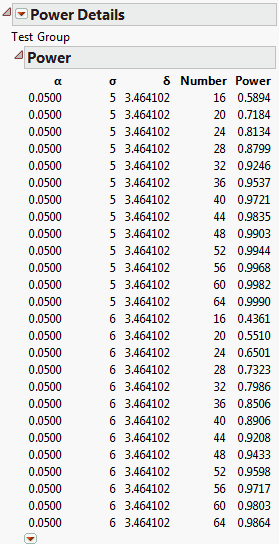

The Power Details report, shown in Figure 2.75, replaces the Power Details window. This report gives power calculations for α = 0.05, for all combinations of σ = 5 and 6, and sample sizes of 16 to 64 in increments of size 4. When σ is 5, to obtain about 90% power, you need a total sample size of about 32. You need 16 participants in the control group and 8 in each of the treatment groups. On the other hand, if σ is 6, then a total of 44 participants is required.
Figure 2.75 Power Details Report for Bacteria Study

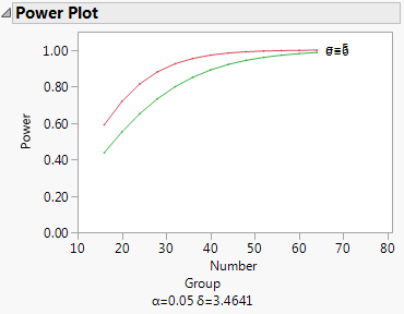

Click the arrow at the bottom of the table in the Power Details report to obtain a plot of power versus sample size for the two values of σ, shown in Figure 2.76. Here, the red markers correspond to σ = 5 and the green correspond to σ = 6.
Figure 2.76 Power Plot for Bacteria Study
