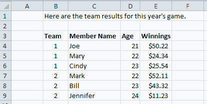

For the figures in this example, we used the Team Results.xlsx file located in the JMP Samples/Import Data folder. The file has the following characteristics:
Figure 2.2 Team Results.xlsx Worksheet

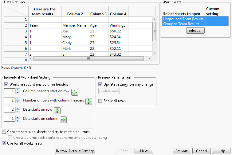

To open an Excel file in JMP, select File > Open.
The worksheet opens in the Excel Import Wizard, where a preview of the data appears along with import options (Figure 2.3).
Figure 2.3 Example Initial Data Preview
Note: JMP remembers your previous changes each time you import a worksheet, even after closing and reopening JMP. This feature is helpful when you want to reimport the same worksheet several times and experiment with options. To clear those changes when you import a different worksheet, click Restore Default Settings.

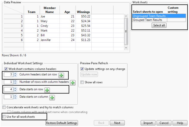

Type 3 for Column headers start on row
5.
Type 4 for Data starts on row.
6.
Select Ungrouped Team Results in the Worksheets pane.
7.
Deselect Use for all worksheets.
Figure 2.4 shows your changes.
Figure 2.4 Selecting the Column Header Row
See Individual Worksheet Settings for details about all options.

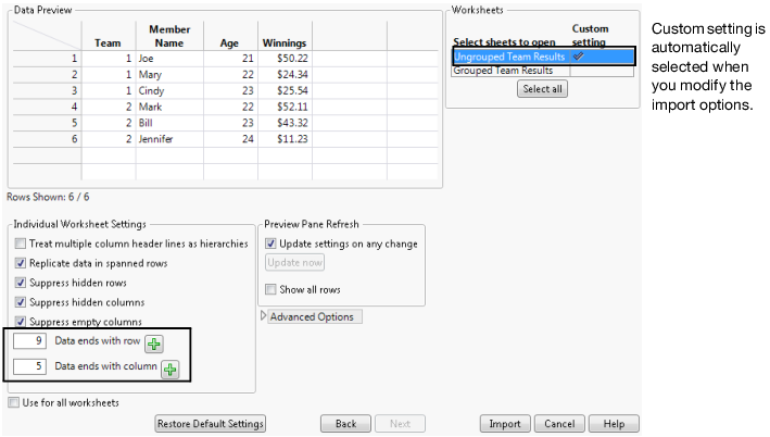

9.
For Data ends with row, type 9.
10.
For Data ends with column, type 5.
Figure 2.5 shows your changes.
Figure 2.5 Specifying the Last Column
See Additional Individual Worksheet Settings for details about all options.

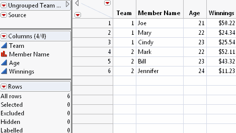

11.
Figure 2.6 Final Data Table

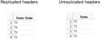

Repeats the header text in each cell for rows that are spanned in the worksheet. For example, the State column heading shown in Figure 2.7 was in a merged cell in the worksheet. On the left, the heading is replicated. Deselect the option to avoid repeating the heading as shown on the right.
Figure 2.7 Replicated Headers in a Microsoft Excel File

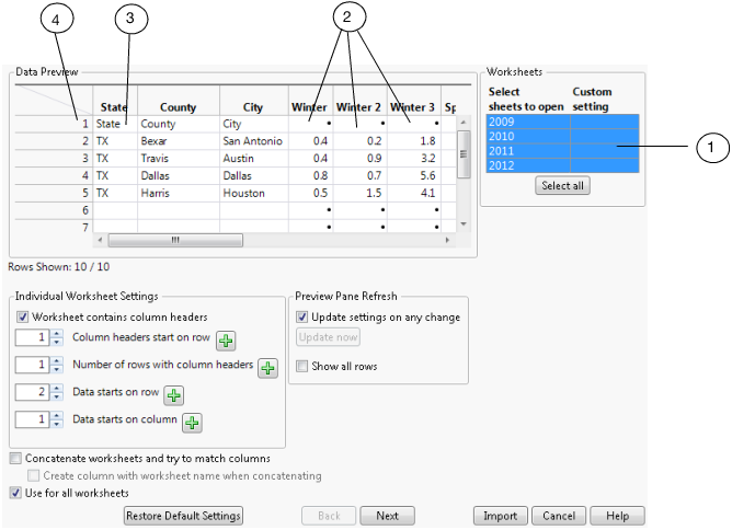

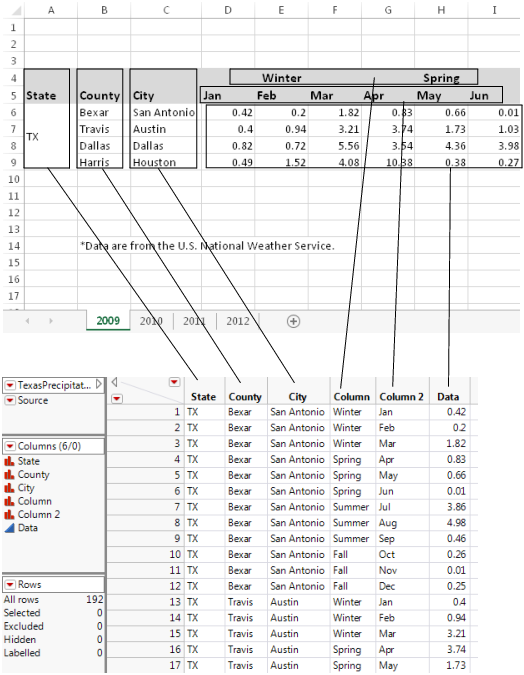

In an Excel worksheet, multiple header rows can have an implied hierarchy; the second header row contains data that are categories of the first header row. Figure 2.8 shows an example. In the worksheet at the top, the seasons “Winter” and “Spring” are in spanned cells above the months within those seasons. In the JMP data table, you want the seasons in one column and their corresponding months in another column.

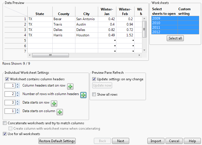

In JMP, select File > Open.
In the Open Data File window, select Texas Precipitation.xlsx, located in the JMP Samples/Import Data folder, and then click Open.
Figure 2.9 Excel Import Wizard Preview
Figure 2.9 shows the default settings for this worksheet:
Under Preview Pane Refresh, make sure that Update settings on any change is selected.
Next to Number of rows with column headers, click the up arrow once.
Notice that Data starts on row automatically updates to 3.
Figure 2.10 shows the updated settings.
Figure 2.10 Updated Settings on Page One

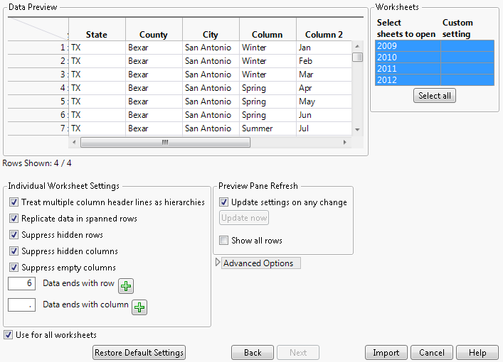

5.
Click Next.
6.
Select Treat multiple column header lines as hierarchies.
7.
Next to Data ends with row, type 6 and press Enter.
Tip: Instead of you typing the end row number, JMP can calculate the row for you. In the Data Preview pane, select row 4. Click the plus sign
next to Data ends with row.
next to Data ends with row.Figure 2.11 shows the updated settings.
Figure 2.11 Updated Settings on Page Two
Notice that Replicate data in spanned rows is selected by default. JMP unmerges data that were merged in the worksheet and copies the cell contents as separate categories. “TX” was originally in a merged cell. In JMP, it will be copied into separate cells.

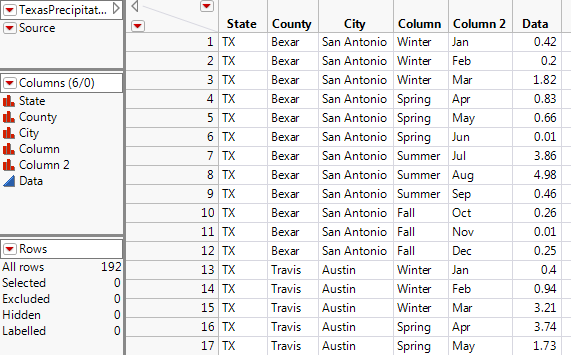

The four worksheets open as separate data tables. The data tables contain a Source script, which you can run to import the data into new data tables using the same import settings (Figure 2.12). Your import settings are also saved the next time you open the worksheet in the Excel Wizard in any JMP session.
Figure 2.12 The Final Data
