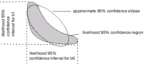

Figure 12.20 shows the contour of the goal SSE or negative likelihood, with the least squares (or least loss) solution inside the shaded region:
Figure 12.20 Diagram of Confidence Limits for Parameters
