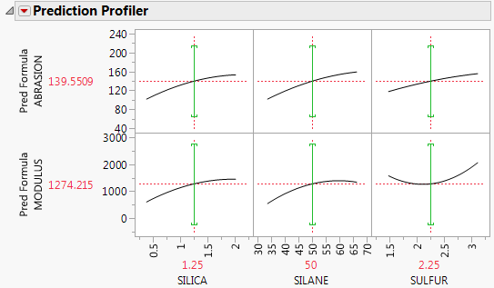

Figure 2.36 Green Propagation of Errors Bars in the Prediction Profiler
where σy is the user-specified sigma for the response column, and σx is the user-specified sigma for the factor column.
centered, with δ=xrange/10000
