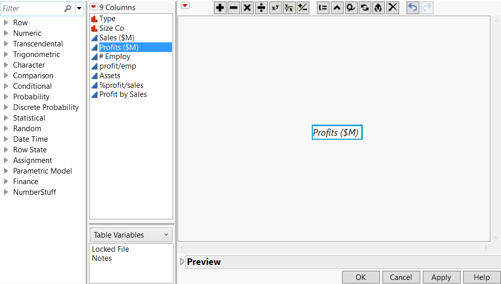

With the box selected, select Profits ($M) from the Columns list.
Figure 6.3 Adding the Profits ($M) Column
