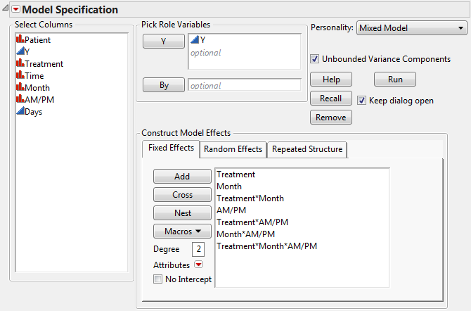

Select Analyze > Fit Model.
Select Keep dialog open so that you can return to the launch window in the next example.
5.
Select Mixed Model from the Personality list.

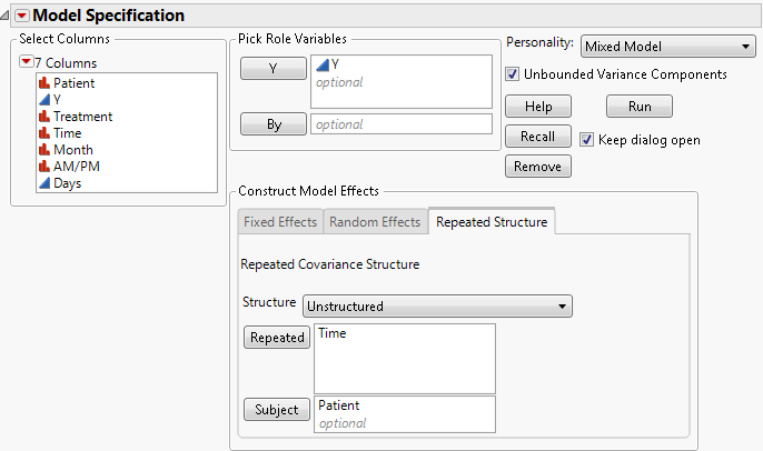

Select the Repeated Structure tab.
8.
Select Unstructured from the Structure list.
9.
10.
11.
Click Run.

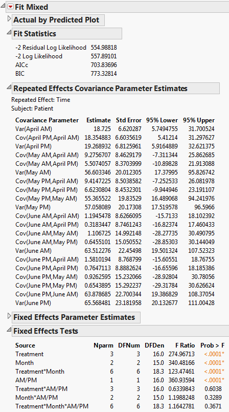

The Fit Mixed report is shown in Figure 7.14. Because you want to compare your three models using AICc or BIC, you are interested in the Fit Statistics report. The AICc for the unstructured model is 703.84.

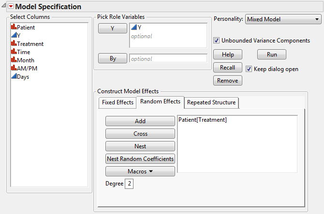

Select the Random Effects tab.
5.
6.
7.
Click Run.

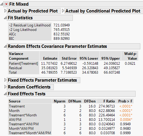

The Fit Mixed report is shown in Figure 7.16. The Fit Statistics report shows that the AICc for the Residual model is 832.55, as compared to 703.84 for the Unstructured model.

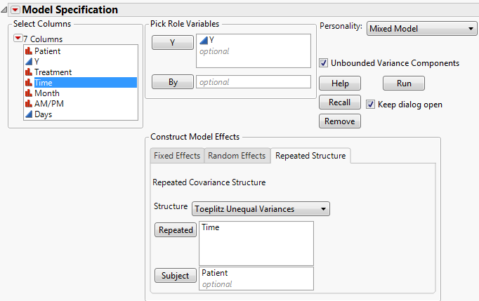

Select Toeplitz Unequal Variances from the Structure list.
5.
6.
7.

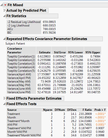

Click Run.
The Toeplitz Unequal Variances structure requires the estimation of eleven covariance parameters. These estimates are shown in the Repeated Effects Covariance Parameter Estimates report. The Toeplitz correlation estimates are shown, followed by the variance estimates for each time point. See Repeated Measures for information about how this matrix is parameterized.

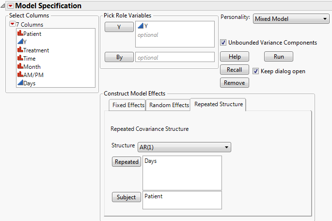

If you are continuing from the previous example, select Time in the Repeated box and then click Remove.
Select AR(1) from the Structure list.
5.
Click Run.

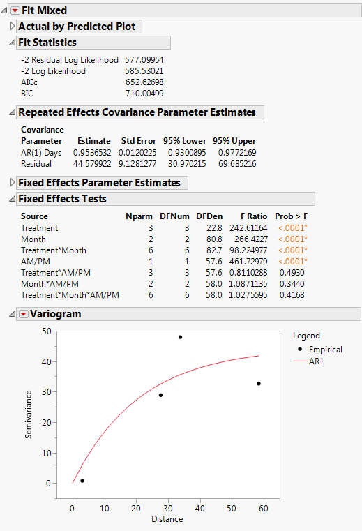

The Fit Mixed report is shown in Figure 7.20. The Fit Statistics report shows that the AICc for the AR(1) model is 652.63. Compare this number to 832.55 for the Residual model, 703.84 for the Unstructured model, and 788.03 for the Toeplitz Unequal Variances model. Based on the AICc criterion, the AR(1) model is the best of the four models.
The AR(1) structure requires the estimation of two covariance parameters. These estimates are shown in the Repeated Effects Covariance Parameter Estimates report. The AR(1) Days parameter estimate is an estimate of ρ, the correlation parameter in the AR(1) structure.
The Variogram plot shows the empirical semivariances and the curve for the AR(1) model. Since there are only five nonzero values for Days, only four distance classes are possible and only four points are shown. The AR(1) structure seems appropriate. To explore other structures, select options from the red triangle menu next to Variogram. For more information about Variogram options, see Variogram.

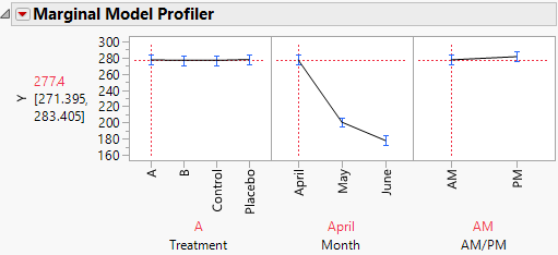

The Marginal Model Profiler report (Figure 7.21) enables you to see the effect on cholesterol levels (Y) for various settings of Treatment, Month, and AM/PM.
In the plot for Month, drag the vertical dotted red line from April to May and then to June.
Notice that the predicted AM measurements for Y decrease over the three months from a mean of 277.4 in April to a mean of 177.7 in June.

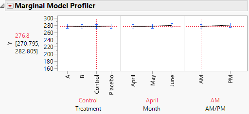

In the plot for Treatment, drag the vertical dotted red line from A to B.
By dragging the line in the plot for Month from April to June, you see that, for Treatment B, the predicted AM mean for Y decreases from 276.8 in April to 191.2 in June.
In the plot for Treatment, drag the vertical dotted line to Control and then to Placebo.
Notice that when you set Treatment to Control or Placebo, you see virtually no change over the three months (Figure 7.22).

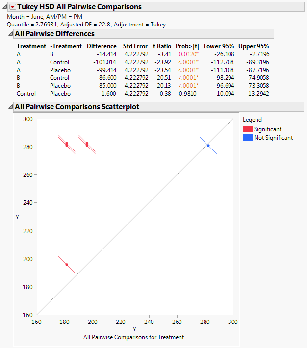

Note that Treatment A seems to result in lower cholesterol readings in May than Treatment B does. If this effect is significant, it might indicate that Treatment A acts more quickly than B. The next section, Compare All Treatments in June, shows you how to evaluate the treatments.
Figure 7.21 Marginal Profiler Plot for Treatment A
Figure 7.22 Marginal Profiler Plot for Control

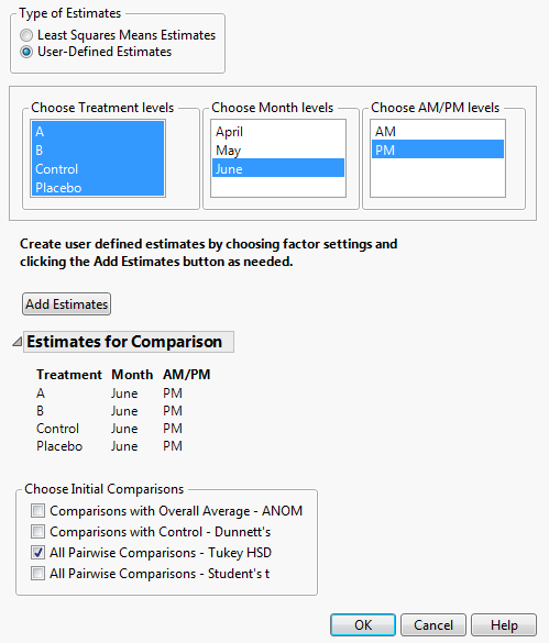

Click the red triangle next to Fit Mixed and select Multiple Comparisons.
Under Types of Estimates, select User-Defined Estimates.
6.
Click Add Estimates.
7.
From the Choose Initial Comparisons list, select All Pairwise Comparisons - Tukey HSD.
Figure 7.23 Completed Multiple Comparisons Window
8.
Click OK.

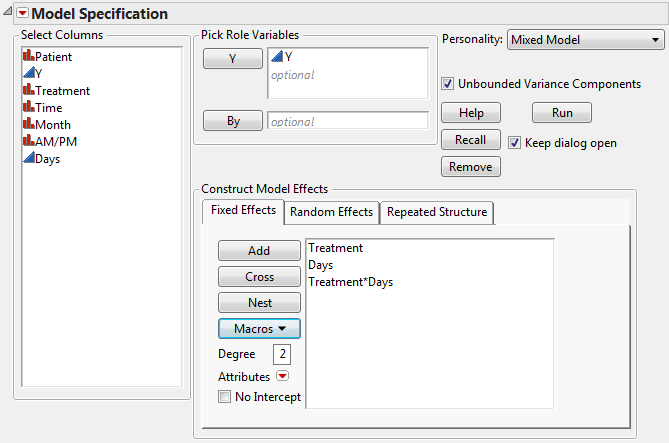

After following step 1 to step 4 in Covariance Structure: AR(1), return to the Fit Model launch window.
Click Run.

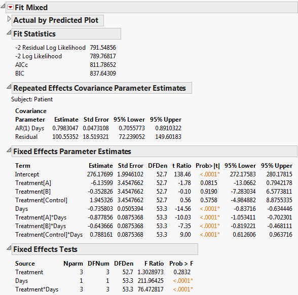

The Fit Mixed report is shown in Figure 7.26. You see that the interaction of Treatment and Days is highly significant indicating different regressions for the drugs.
