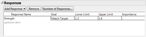

Figure A.4 Responses Outline in Custom Design Window

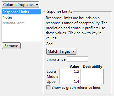

In the Coffee Data.jmp sample data table, select the Strength column and select Cols > Column Info.
Figure A.5 Response Limits Column Property for Strength
The Goal is set to Match Target.
7.
Select the Show as Graph Reference Lines option.

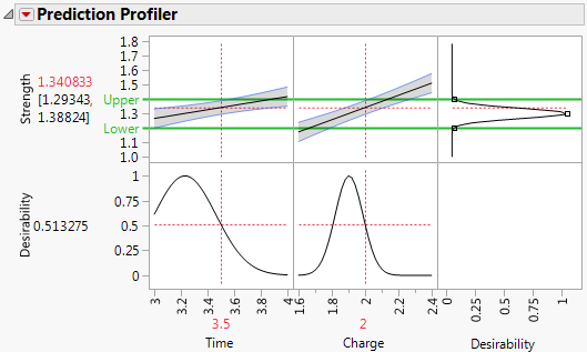

In the Coffee Data.jmp data table, click the green triangle next to the Reduced Model script.
10.
Click Run.
Figure A.6 Profiler Showing Desirability Function for Strength
The desirability function for Strength appears in the plot at the right above Desirability. This plot appears because the data table contains a Response Limits column property for Strength. The Prediction Profiler also shows reference lines for the Lower and Upper limits for Strength.
11.
Hold down the Ctrl key and click the Strength plot for Desirability.
Figure A.7 Response Goal Window for Strength
The Desirability plot in Figure A.6 shows how JMP uses the Desirability values shown in Figure A.7. The Desirability function for Strength is essentially 0 beyond the Low and High values and it increases to 1 gradually as Strength approaches the target of 1.3. The Importance value is set to 1 since there is only one response in the model.

Select Optimization and Desirability > Maximize Desirability from the Prediction Profiler red triangle menu.
The settings for Time and Charge are updated to show settings for the factors that maximize the desirability function for Strength. However, many other settings also maximize the desirability function. See Contour Profiler in the Profilers book for information about how to identify other settings that maximize the desirability function.
