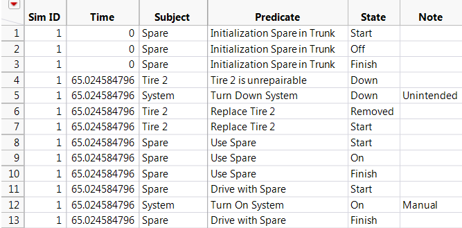

Figure 11.10 RSS Results Table
Notice that the first entry in Figure 11.10 is the start of the Initialization Spare in Trunk action, which has an immediate completion time. The action turns the Spare component off and then finishes while Time is still 0.
