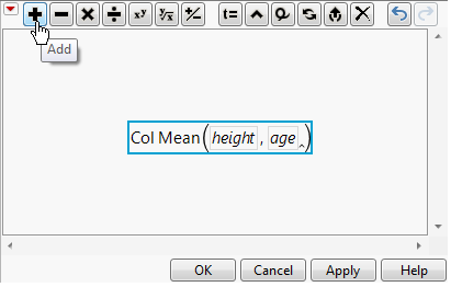

Figure 3.23 Click the Plus Sign
8.

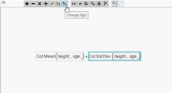

Click Statistical > Col Std Dev.
9.
Click height.
Figure 3.24 Formula for Upper Bound

Figure 3.25 Selecting Col Std Dev and Making It Negative

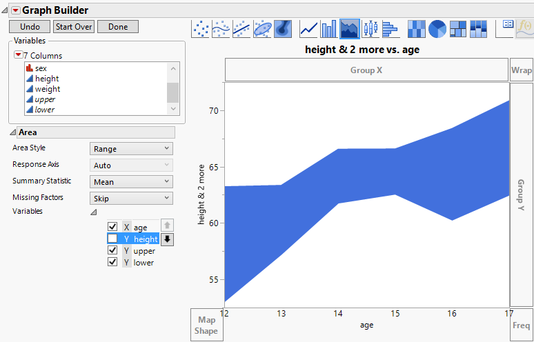

Figure 3.27 Area Plot
7.

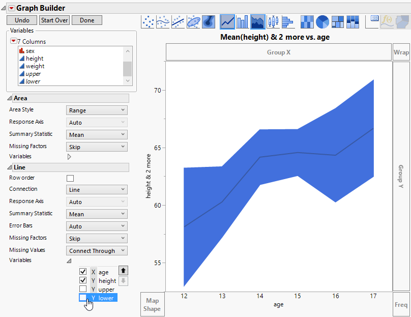

In the Line options, click the triangle next to Variables. De-select Y upper and Y lower. See Figure 3.28.
Figure 3.28 Area Plot with Mean Line

The dark blue line connects the mean heights for each age group. As expected, height tends to increase as age increases. The shaded area shows a range of one standard deviation above and one standard deviation below the mean height at each age group.
