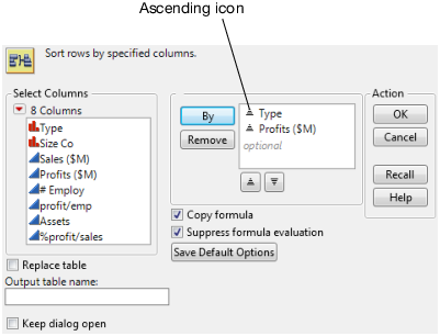

Use the Sort command to sort a data table by one or more columns in the data table. For example, look at financial data for computer and pharmaceutical companies. Suppose that you want to sort the data table by Type, then by Profits ($M). Also, you want Profits ($M) to be in descending order within each Type.
At this point, both variables are set to be sorted in ascending order. See the ascending icon next to the variables in Figure 1.39.
Figure 1.39 Sort Ascending Icon
5.
To change Profits ($M) to sort in descending order, select Profits ($M) and click the descending button.
Figure 1.40 Change Profits to Descending
6.
Select the Replace Table check box.
When selected, the Replace Table option tells JMP to sort the original data table instead of creating a new table with the sorted values. This option is not available if there are any open report windows created from the original data table. Sorting a data table with open report windows might change how some of the data is displayed in the report window, especially in graphs.
